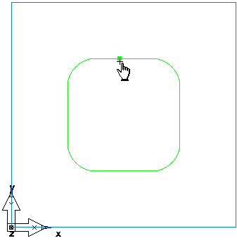

  2. In the New Feature wizard, select the Die option in the 2 Axis frame, and click Next.
  3. On the Curves page, click the Pick curve or geometry button, select the curve you created, and click Next.
