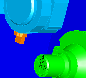

The Local Coordinate System of the sub-spindle is important in terms of simulating sub-spindle positioning features. Typically the sub-spindle is positioned with respect to a machine coordinate system and not the part program (or Setup) zero. Set the Local Coordinate System's Z direction to match the machining sub-spindle commands. That is, if the machine's sub-spindle moves to the left in response to a negative W (or sometimes B), set the Z direction of the LCS pointing to the right (like the main spindle or turning main setup). Sometimes the positive W axis points to the left, that is, the machine moves to the left in response to a positive W (assuming W=0 is the home position). You can set the home W and max W in the .cnc file (Edit the .cnc file, and go to CNC-Info > Spindles).
Here, the sub-spindle's LCSs (UCS shown) Z direction points to the right; this would be correct for a machine where a move the sub-spindle in to grab the part is a negative W and the move the sub-spindle home is a W of zero.
