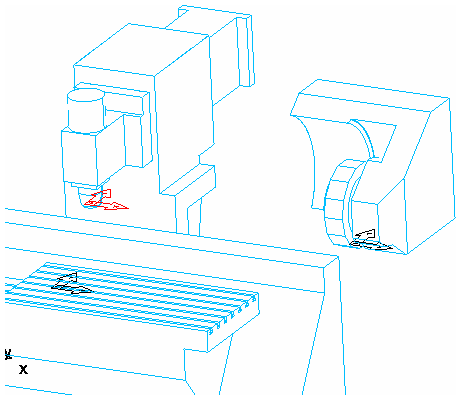

Share Email Facebook Twitter LinkedIn Tool direction The tool location orientation is the same for milling and turning, where +Z points into the quill or turret. The following image shows both a machine tool spindle and lathe turret for illustration purposes only: Parent topic: Configuring the machine
