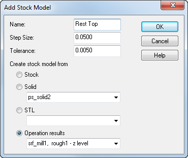

You can use these results to create a Stock Model.

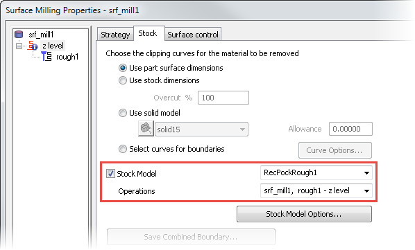

There is a lot of air cutting. You can use the stock model that you created from the first Z-level rough operation to avoid air cutting.
To do this, on the Stock tab for the second feature, select Stock Model and select the stock model name and the operation you want to use from the Operations list:
Using the stock model, the Z-level rough toolpath for the second feature has minimal air cutting:
