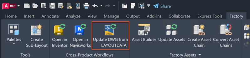

Added the commands that enable you to manually update the DWG and NWF file with any existing changes from the LAYOUTDATA file.
You can access it from the Cross-Product Workflows panel of the Factory tab:
  • AutoCAD - Update DWG from LAYOUTDATA

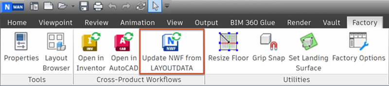

  • Navisworks - Update NWF from LAYOUTDATA
    Factory Options dialog
If you click it, any changes you have made to the LAYOUTDATA file in another application, such as Inventor, will be updated in the DWG or NWF file.
For more information, see AutoCAD - Update DWG from LAYOUTDATA and Navisworks - Update NWF from LAYOUTDATA.
