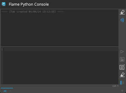

Accessible from the Flame menu, the Flame Python Console is your main tool when using the Python API. It allows you to write, edit, and run code, while being able to view the console output. The major parts are discussed in this section.
Console windows:
  • Terminal Window: This is where any output from your code will be shown. The terminal is useful when debugging an error, you will get a detailed report of the error within the console (in a red font). This is also the place where any "print()" command or any calls to the help() function will be outputted.
  • Editor Window: The Editor window is a simple text editor used to write or edit your Python scripts. The editor has the feature of being able to have multiple tabs of Python Script files; you can access the multiple tabs underneath the editor's window. To create a new tab, simply click the 'plus' (+) sign in the bottom right corner of the Python Console.
IconNameDescription
EraserClears all output in the terminal window
Sound WaveChoose whether the Python code that is executed will be displayed within the terminal (Will output when icon is Blue)
Play ButtonExecutes all code within the current tab of the editor window or selected code segments
SavePrompts user to save the script in the current tab of the editor
LoadPrompts user to load a Script which will become a new tab in the editor
EraserClears all code within the current tab of the editor
Line Number IndicatorToggling this button will show or hide line numbers within the editor (Line numbers will be visible when icon is blue)
