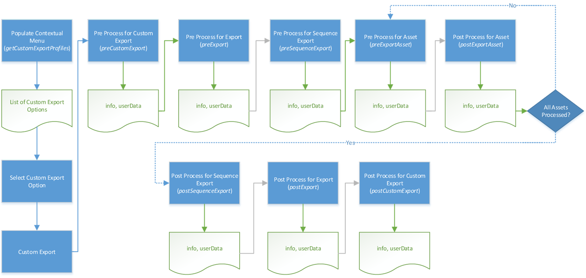

exportHook.py
exportHook.py contains all the hooks related to exporting clips.
These hooks are used when the user exports from the application.
Export hooks are called in the following order:
pre_custom_exportOptional. Called if required byget_custom_export_profiles. Called when the context menu item defined by getCustomExportProfiles is selected by the user.pre_exportAlways called. In a regular export,pre_exportis called as the Export window is displayed to the user. In a custom export, called afterpre_custom_export.pre_export_sequenceAlways called. Called before writing the sequence.pre_export_assetAlways called. When it is called depends on the export option. With Foreground Export, allpre_export_assetare called for each assets immediately in one go. With Background Export, eachpre_export_assetis called as each asset job is submitted to Backburner.post_export_assetAlways called. Called after an asset is written. Can be done in backburner as determined by useBackburnerPostExportAsset.post_export_sequenceAlways called. Called afterpost_export_asset.post_exportAlways called. Called afterpost_export_sequence.post_custom_exportOptional: called if required byget_custom_export_profiles. Called afterpost_export.
