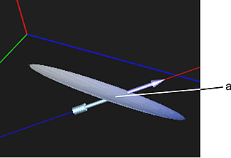

To add vertices to the hull and move them:
  1. Select the key element by clicking it.
  2. Position the arrow of the selected element in the direction in which you want the ellipsoid or patch to grow or shrink. For example, point the arrow towards colours you want to include in your sample. Alternatively, plot a point to position the arrow. See Controlling Elements with the Directional Arrow.
  3. Press and hold V on the keyboard and click anywhere in the RGB viewer.
    A vertex is added to the hull at the intersection of the arrow and the edge of the ellipsoid or patch.
    (a) Vertex is added to the hull
    Note: When using V in the RGB viewer, you can scale any convex hull (tolerance, softness or patches). If you use V in the image window, it will apply to softness only.
  4. To add colours to the sample, drag the cursor to the right. This moves the vertex in the forward direction of the arrow.
    To remove colours from the sample, drag the cursor to the left. This moves the vertex backward towards the centre of the element.
    When you are satisfied with the result in the image window, release the cursor.
    The hull is reshaped as you move the vertex. If you did not display the convex hull, it is temporarily displayed while you are moving the vertex. The direction of the arrow may change slightly as you move the vertex, but the direction it moves in is always the direction in which the arrow was initially pointing.
    Note: You can release the V key and the cursor, then press them again to scale the same vertex. You retain control over the new vertex until you change the position of the arrow.
