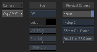

You control the density and colour of the fog using the fog controls in the Camera menu's Fog / DOF tab..
