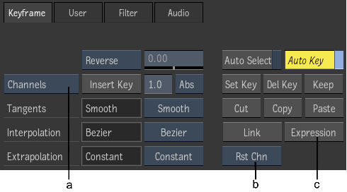

    The Animation controls appear.
    (a)Channel View box (b)Reset Channel button (c)Expressions button

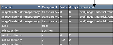

    Channel information appears in a tabular grid for easier viewing of expressions and channel details. From Info view, you can click the Expressions column heading to sort by expressions and view them more easily.

  4. In the Animation controls, click Expression.
    The Expression field appears below the Channel Editor.
