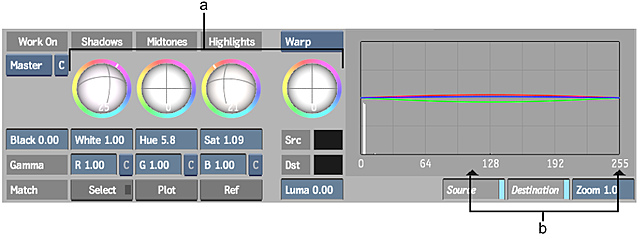

    (a) Trackballs  (b) Midtones triangles  

  2. To add a colour cast to the entire image, drag the midtones triangles so that they span the entire luma range.
  3. While viewing a vectorscope and the image, drag the Midtones trackball towards the colour you want to increase in the clip or image. For example, to add more yellow to the image, drag the Midtones trackball towards yellow.

  4. To increase a range of colour in the highlights or shadows of the image, drag the Highlights or Shadows trackball.
