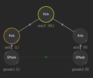

Using the GMask Tracer in Stereo Mode
If you want to work in stereo mode with the GMask Tracer:
- From the Tools menu, make sure that you select a stereo input (Left Front/Matte / Right Front/Matte or Left Front / Right Front).
- From Batch: make sure that you enable Stereo Mode (below the node bin) first before adding the GMask Tracer node, so that the proper stereo inputs are present.
In this case, once you enter the GMask Tracer and add a GMask node, a stereo rig and stereo camera are added to the schematic. In the menu for the parent Axis node, you can set the stereo convergence (Convergence is displayed as Offset in the Channel Editor under the parent Axis folder).

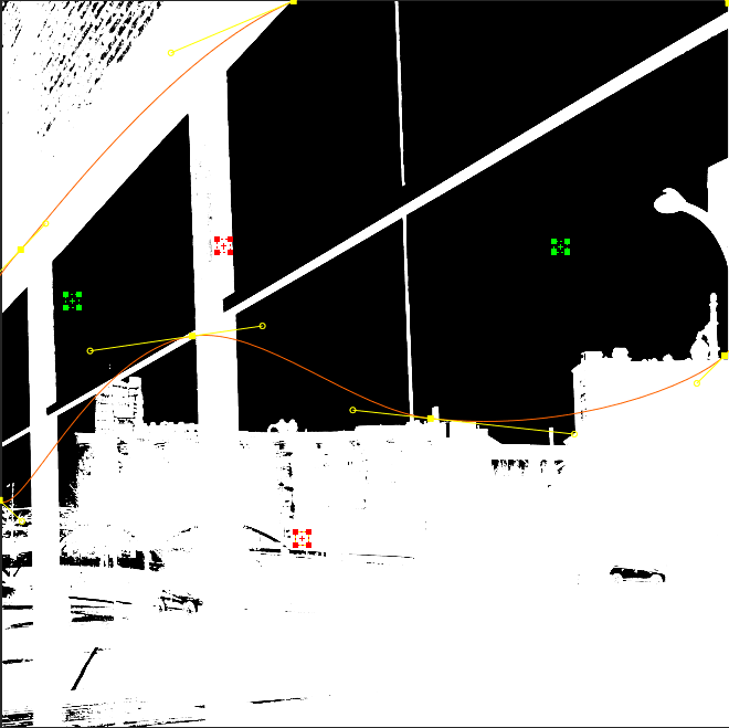

The GMask Tracer User Interface
Once you enter the GMask Tracer user interface, you should be familiar with the look and layout, as it resembles the Action interface, with a schematic, node bin, priority editor, and output menu.
The GMask node is usually the primary node that you use within the GMask Tracer, but many other nodes are available in the GMask Tracer node bin to help you create your mattes. You can create a new GMask quickly without using the node bin by using the GMask: Create Node shortcut. Press Alt+N to automatically switch to Draw Shape mode, then once you add your first point, a GMask node is automatically added to the schematic.
