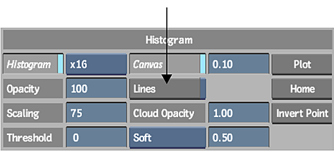

The Preferences menu contains the Lines button. Use this button to display lines around key elements when they are selected in the viewer. This can make it easier to identify the selected key element.

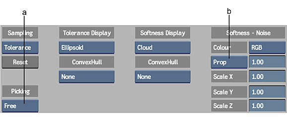

The Picking box must be set to Free to select an element by clicking it. Also, the Softness Scaling must be set to Prop not Minimize Noise (Minimize Noise selects softness and controls the arrow direction).
To select key elements by clicking:
  1. In the Key menu, select Free from the Picking box and make sure that Prop is selected in the Softness Scaling box.
    (a) Softness Scaling box  (b) Picking box  
  2. Select a key element in the RGB viewer by clicking it.

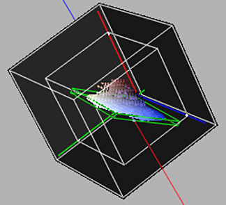

    A directional arrow appears through the selected key element and, if the Lines button is enabled, a green wireframe box appears around the selected key element.

  1. In the Key menu, verify that the Softness Scaling is set to Prop (Minimize Noise forces the softness to be selected).
  2. Select the key element from the Picking box.
    If lines are displayed in the viewer, a selected ellipsoid has a green wireframe box around it and patch boxes change from white to green. If the element's arrow direction has been set, the arrow is displayed.
