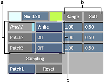

    (a) Patch buttons  (b) Patch controls  (c) Patch boxes  

  7. To improve the patch, use the Patch controls.
    Drag:To:
    RangeIncrease or decrease the colour range that is included in the patch.
    SoftSoften the edge.
