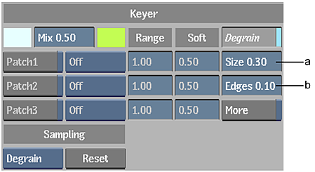

  4. Drag in the Degrain fields to modify the grain size and restore edge sharpness.
    (a) Size field  (b) Edges field  
    Drag:To:
    SizeEstimate the size of the grain in the image.
    EdgesDe-sharpen the edge of the image. By default, Degrain sharpens the edges. Use the Edges field to restore the natural look of the edges in the image.
