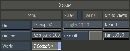

  4. Adjust the view with the Ortho Views controls, if needed.
    When using an orthographic view, you may notice that parts of the object you are viewing are getting cut off. Adjust the near and far ortho views. You gain more space to view the object, but lose some viewing precision.
    In the Display section of the Action Setup menu, adjust the Near and Far fields.
    Note: The Ortho Views parameters in the Action Setup menu are only for viewing objects, and cannot be animated or saved. The Near and Far fields in the Camera menu are used to set clipping planes. See Moving the Near and Far Clipping Planes.
