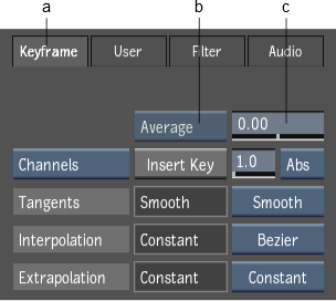

Select the Keyframe tab from the Animation Controls tabs
Select Average from the Curve option box.
(a) Keyframe tab (b) Curve option box (c) Curve Value field
Enter an average value in the Curve Value field.
The transformation is applied to the curves. The Curve Value field defaults back to 0, where 0 always represents the average of the current curve.
