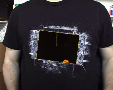

  5. Adjust the four corners to match the t-shirt.
    Image courtesy of P. Fua, CVLab, EPFL, Switzerland

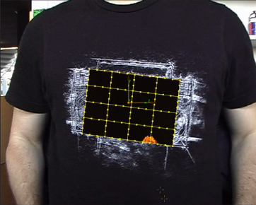

  6. Because the t-shirt deforms much more than the four corners, subdivide the surface, by clicking the Subdivide button twice.

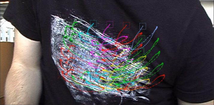

  12. Adjust the tracker size, to adjust the sampling area. In this case, we want to make them a little bit bigger.
  13. Press Analyze.
    The motion is tracked.

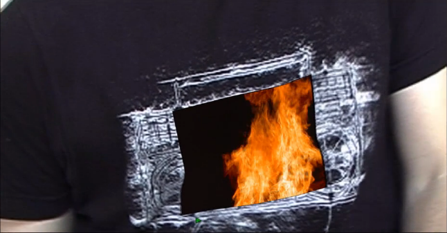

  14. Exit the Stabilizer.
    The fire surface organically follows the t-shirt displacement.
