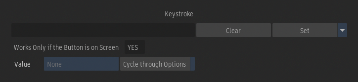

Keystroke Editor
Note: The available options depend on the button you select. For example, Increment is only available when you select a numeric field.
Keystroke field
Displays the keystroke sequence. Click keys in the on-screen keyboard or the computer's keyboard to enter a new sequence.
Clear
Clear the Keystroke field.
Set
Set the content of the Keystroke field.
Set option
Set the content of the Keystroke field for all operating systems, or only for the current operating system.
Works Only if the Button is On Screen field
Indicates if the selected keyboard shortcut only works if the button is visible.
Value Type option
Select a value type for the selected keyboard shortcut.
Increment
Set the increment for the selected value type.
Cycle through Options
Enable to allow the new keyboard shortcut to cycle through options for the selected drop-down button.
