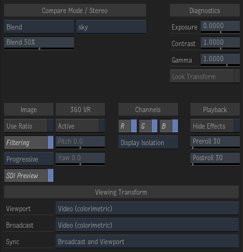

Viewing Settings tab
Compare Mode /Stereo
Compare Modes box
Select the comparison mode to compare the current frame to a grabbed reference frame. Use the Reference box to select a reference frame.
Reference box
Grab a frame to create a new reference frame or select a reference to use in the comparison.
Use Ratio button
Enable to simulate rectangular pixel display that corresponds to the delivery format.
Filtering button
Enable to set the filtering.
Scan Mode button
Adjusts the display to the desired scan mode format.
Playback
Hide Effects button
Enable to hide effects during playback. Disable to display effects (may affect performance).
Preroll field
Displays the number of preroll frames when playing a clip.
Postroll field
Displays the number of postroll frames when playing a clip.
360 VR button
Enable to activate the 360 VR mode. Use the widget inside the Player or Viewport to navigate in the clip.
Pitch Slider
Use to modify the longitude of the 360 VR Viewer.
YAW Slider
Use to modify the latitude of the 360 VR Viewer.
Exposure, Contrast, and Gamma
Exposure field
Displays the exposure in F-stops used to adjust the display for diagnostic purposes. Press Shift+E and drag left or right in a viewport to adjust.
Contrast field
Displays the contrast, pivoting around grey, used to adjust the display for diagnostic purposes. Press Shift+C and drag left or right in a viewport to adjust.
Gamma field
Displays the gamma used to adjust the display for diagnostic purposes. Press Shift+W and drag left or right in a viewport to adjust.
Enable Look Transform button
Toggles the Look component of the OCIO view used in the viewport on or off. Available only when the selected OCIO view has a Look operator defined.
Channels
Red Channel button
Enable to display the red channel of the clip. You may press Shift+R to enable and Shift+R again, or Shift+Z, to disable.
Green Channel button
Enable to display the green channel of the clip. You may press Shift+G to enable and Shift+G again, or Shift+Z, to disable.
Blue Channel button
Enable to display the blue channel of the clip. You may press Shift+B to enable and Shift+B again, or Shift+Z, to disable.
Isolation button
Use Source Isolation to isolate the selected channel as a grey scale image, then apply the viewing transform. Use Display Isolation to isolate the selected channel(s) after the viewing transform (this is equivalent to turning off channels in the display itself). You may press Shift+X to toggle between the two modes.
Viewing Transform
Graphics Monitor View option
Select the OCIO view to use for the graphics monitor viewport.
Video Preview Device View option
Select the OCIO view to use for the video preview device.
Viewport and Video Preview Synchronization option
The "Video Preview and Viewport" option synchronizes the OCIO view between the Video Preview and Viewport, and across Multi- and Player Viewports. The "Do Not Sync" option allows you to assign a view to the Video Preview device that differs from the one assigned to the Multi- and Player Viewports. Note that if the displays for the Graphics Monitor and Video Preview Device have different views defined in the OCIO config file, syncing may not always be possible.
Notes:
  • The Colour Management settings (Exposure, Contrast, Gamma) of a viewport are bypassed in the video preview device when Viewport Monitoring is enabled in the Players & Monitoring preferences, and the Bypass option is enabled in the viewport.
  • The selected Viewing Transform of a Player view is now shared between its different tabs (Source, Sequence, Container, Batch) even if "Do not Sync" is the selected option.
