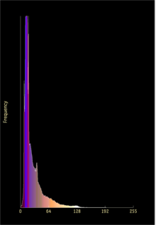

Histograms
There are two Histograms to choose from. For each Histogram, you can choose between the following modes: Red, Green, Blue, RGB, RGB Parade, Luminance - Colours and Luminance - Mono, and can set the signal intensity, from the Preset Widgets tab of the Scopes Settings. The difference between the two available Histograms is their horizontal scale.
Note: The Histogram is clamped at the top. A yellow line appears at the top when the value goes beyond this range.
WidgetAvailable SettingsImage
HistogramVideo: Displays the tonal values of your image on a linear scale, between 0 and 255.
In the Scopes Settings, you can select the histogram's range in the Preset Widgets tab.
  • [ 0, 1 ]: The minimum and maximum values are set to 0 and 1. Data above or below this threshold is not displayed.
  • Full Range: The minimum and maximum values are based on the frame displayed in the Player / Viewport. This range does not update during playback.

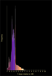

HistogramF-Stop: Displays the tonal values in terms of the number of photographic stops (f-stops) relative to 18% grey. These are the traditional units photographers/cinematographers use to judge lighting and exposure in a scene. Each stop represents a factor of two (doubling or halving) of the amount of linear light, or exposure.
  • Colours in log colour spaces are linearized before calculating the waveform.
  • Requires scene-linear or log colour spaces. It is incompatible with Video, Data, or Unknown colour spaces.
  • Shows the source image data and does not apply the view transform for the viewport

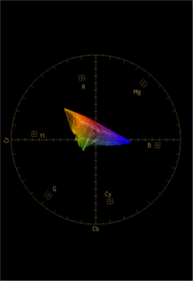

Vectorscopes
There are five Vectorscopes to choose from. For all of the Vectorscopes, you can choose between the following modes: Colours and Mono and can set the signal intensity, from the Preset Widgets tab of the Scopes Settings.
Every vectorscope but Video CbCr display colours in absolute units. This allows you to compare the value of a colour relative to specific gamut boundaries. Traditional video scopes simply display the value of a colour relative to the boundaries of its specific integer encoding, meaning there is no way to compare DCI-P3 vs. Rec.709. These absolute scopes are particularly well-suited to checking the colours from camera-raw source footage in either logarithmic or scene-linear working spaces. However they can also be used with video colours, to check whether a DCI-P3 master has any colours outside the Rec.709 gamut.
Note: The absolute-style scopes (Dolby CtCp, CIELAB a*b*, CIELUV u*v* & CIE xy) require knowledge of the colour space of the media and therefore the media must be tagged correctly. Media tagged as "Unknown" will not work with these scopes.
Vectorscope
Video CbCr: This Vectorscope displays the value of a colour relative to the boundaries of its specific integer encoding (in Colour mode).

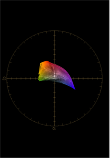

Dolby CtCp: The chroma axes from Dolby's ICtCp colour space (also part of Rec.2100). This space was specifically developed for HDR video applications.
Vectorscope

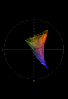

CIELAB a*b*: The chroma axes from the CIELAB colour space. This is a roughly perceptually uniform space that is used in Photoshop and in ICC colour management. This colour space was developed before the advent of HDR video.

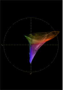

CIELUV u*v*: The chroma axes from the CIELUV colour space. This is a companion space to CIELAB - similar but more oriented towards video applications. It is essentially a CIE u'v' chromaticity diagram that is scaled by lightness so that the gamut converges to a point at black. This colour space was developed before the advent of HDR video.

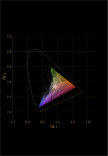

CIE xy: This is the classic CIE chromaticity diagram. It allows comparison of colours in relation to a gamut boundary. The points on the graph represent colour independent of luminance. Blends between two colours in scene-linear space fall on a straight line on this graph.

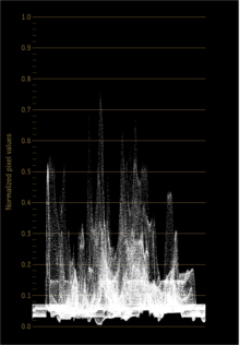

Waveforms
There are four Waveforms to choose from. For each Waveforms, you can select between the following modes: Red, Green, Blue, RGB, RGB Parade, Luminance - Colours and Luminance - Mono, and can set the signal intensity, from the Preset Widgets tab of the Scopes Settings.
Note: The Log, F-Stop & PQ Waveforms require knowledge of the colour space of the media and therefore the media must be tagged correctly. Media tagged as "Unknown" will not work with these scopes.
Waveform
Video: This Waveform displays the range values of video values on a relative scale.
Waveform

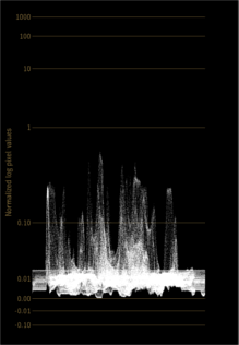

Log: This waveform displays a very wide range of floating-point values via a pseudo-logarithmic scaling on the vertical axis. It allows you to quickly check the maximum values of your media even if these are much larger than 1.0. It also allows you to quickly check for negative values.
  • The numbers on the vertical axis are floating-point linear values regardless of what colour space the source media is in.
  • This waveform is not intended for use with video colour spaces.
Waveform

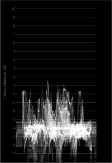

F-Stop: For this waveform, the colours in the media are displayed in terms of the number of photographic stops (f-stops) relative to 18% grey. These are the traditional units photographers/cinematographers use to judge lighting and exposure in a scene. Each stop represents a factor of two (doubling or halving) of the amount of linear light, or exposure.
  • Requires scene-linear or log colour spaces. It is incompatible with Video and Data colour spaces.
Waveform

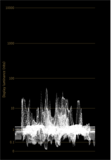

PQ: This waveform displays the luminance of a video signal in units of nits (also known as candelas per square meter).
  • The vertical axis is scaled using the SMPTE ST-2084 "Perceptual Quantizer" function, which is pseudo-logarithmic in nature.
  • This waveform is intended for graphing HDR video media that are already in a PQ space.
  • Other colour spaces are linearized and then the PQ encoding is applied for the waveform.
  • For SDR video signals, the white point is normalized to 100 nits.

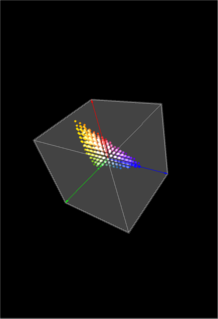

3D Cube
3D Cube
  • You can choose between the following sizes: 8x, 16x and 32x, Preset Widgets tab of the Scopes Settings.
