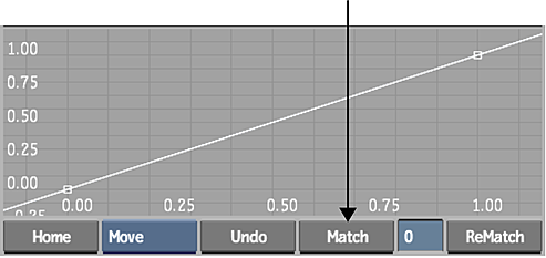

Click Match.
The reference colour is applied to the result clip. The reference colour is also added to the Result colour patch and points are added to the colour curves.
When you use Match, a number is displayed in the numerical field beside the Rematch button. The first match you perform is indicated by a 1 in the field, the second by a 2, and so on. To revert to a previous match, click the numerical field and type the number of the match you want to recall. The colour patches and colour curves reset to the values stored in the specified match.
