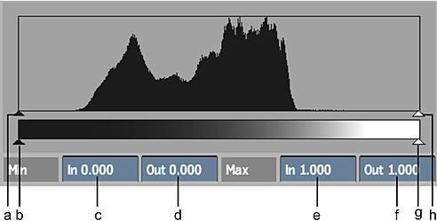

    The Histogram menu options are described as follows.
    (a) Minimum Input slider (b) Minimum Output slider (c) Minimum Input field box (d)Minimum Output field (e) Maximum Input field (f) Maximum Output field (g)Maximum Output slider (h)Maximum Input slider
Input controls
Use the minimum and maximum input sliders or fields to set the input levels of your image.
Output controls
Use the minimum and maximum output sliders or fields to set the output levels of your image.
