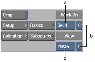

Use the C/R boxes next to the Work On box and Selective View box to reset a matte or a colour correction. C deletes the matte or colour correction at the current frame by setting a keyframe. R deletes the matte or colour correction for the entire animation curve.
(a) Work On box (b) C/R boxes (c) Selective View box
