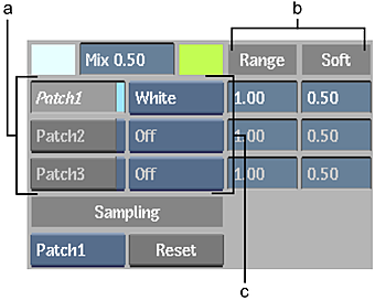

(a) Patch buttons (b) Patch controls (c) Patch boxes

To manually select a patch type, select it from the Patch box.
Note: If you want to reset the patch so that you can automatically select the patch type, you must disable the patch and set the patch type to Off. You can then resample an area in the image and generate a patch type.To improve the patch, use the Patch controls.
Drag: To: Range Increase or decrease the colour range that is included in the patch. Soft Soften the edge.
