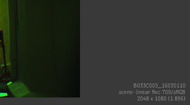

  • It is shown in the lower right corner of many viewports.
