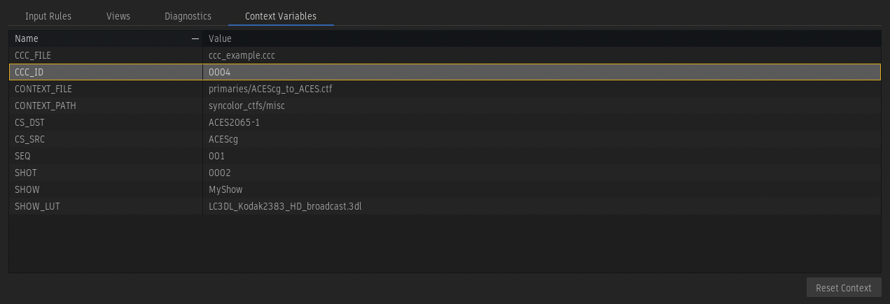

Setting Values in the Colour Management Preferences
In the Context Variables tab of the Colour Management Preferences, you will see the context variables for the config and their current values. Every time you launch the application, the content of this table may be different since the environment variables defined at launch will override the previous values.
If you click on a row in the Value column you may update a context variable to a new value. (The Name may not be changed, only the context variable names defined in the environment section of the config file may be used.) You may click the Reset Context button to reset the table to the values in the source config.
The values defined in the Preferences are the global values that apply everywhere in the application that does not specifically allow you to override them. The following locations only use the current values from the Preferences:

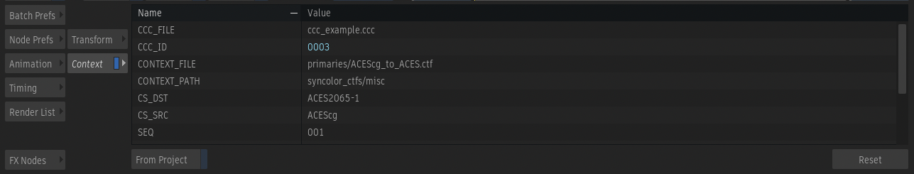

Setting Values in the Colour Mgmt Tool
In the Colour Mgmt node in Batch and the Colour Mgmt Timeline FX, there is a Context tab that allows you to override the global context variables from the Preferences.
If you go into the Context tab, you will see a table of Name/Value pairs. They start out initialised to whatever the current value in the Preferences is. If you turn off the From Project toggle, you will be able to edit the values. Edited values that are different from the Preferences will be shown in a light blue colour. To temporarily revert to the values from the Preferences, you may enable the From Project toggle button.
You may click on the blue "LED" on the Context tab as a quick alternative to using the toggle button. It also shows you if an override is in effect without having to go into the Context tab.
The context variable overrides are copied with the Colour Mgmt setup, for example, if you duplicate a Batch node or use Shift+T+click to copy from one Batch node to another. In addition, they are automatically communicated to any external services such as Burn.
The values will be persisted if you save a Batch setup. If you load the setup into another project that uses a different OCIO config, those context values may, or may not, be relevant. However, any context variables not present in the current config will be ignored.
When the context variables in the Preferences are updated, Colour Mgmt tools that are in From Project mode are notified and updated. If you don't want this to happen, make sure to disable From Project mode in the relevant Colour Mgmt nodes or Timeline FX.
