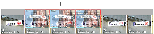

When you drag a source clip over a target clip, the cursor changes as the source clip moves over different areas of the target clip. The type of cursor indicates the type of edit that occurs when you drop the source clip on that spot.
All gestural splices, insert edits, and replace edits ripple the edit sequence; that is, they change the duration of the target clip unless you replace a clip with another clip of the same duration.
To perform a gestural insert or replace edit:
Drag the source clip over the frame in the target clip where you want to make the edit until you see the appropriate edit cursor.
Drop the source clip.
The clip is updated with the edit. The source clip replaces the frames of the target clip
