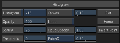

Pref Histogram Settings
Note: The Pref Histogram Settings are available when you select the Pref menu from the Key button.
Histogram button
Enable to display the 3D histogram in the RGB viewer.
Histogram Grid option box
Select an option for the histogram grid resolution.
Opacity field
Displays the percentage of opacity of the cubes.
Scaling field
Resizes the cubes. Cubes representing less prevalent colours are scaled down more than those representing more prevalent colours.
Threshold field
Enter a value to edit the display of colours that are less prevalent in the image. As you increase the threshold, less prevalent colours are increasingly removed from the histogram.
Canvas button
Enable to display the canvas.
Canvas Light field
Sets the lighting in the RGB viewer. The light source emanates from behind the viewer.
Lines button
Enable to display a white outline of the borders of the RGB viewer, and a green wireframe around selected ellipsoids.
Cloud Opacity field
Displays the overall opacity for all ellipses and patches.
Key Element box
Select an element type to change its opacity.
Patch Opacity field
Displays the opacity for the third patch in the RGB viewer.
Plot button
Activates a pick cursor which you use to select a plot value in the image window. If Plot Point is enabled in the Pref menu, a cube with a dashed outline surrounds the point in the RGB viewer.
Home button
Restores the RGB viewer to its original settings and position.
Invert Point button
Inverts the direction of scaling of the softness ellipsoid.
