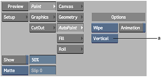

  1. Click AutoPaint, and select Wipe from the AutoPaint Mode box.
    The Wipe menu appears.
    (a) AutoPaint Mode box (b) Wipe Mode box

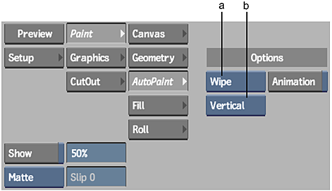

  4. Select the Wipe mode in the Wipe Mode box. If this box is not visible, make sure that the attribute mode for the Direction attribute is set to Direction.
    Select:To:
    DiagonalApply diagonal strokes.
    VerticalApply strokes from top to bottom.
    HorizontalApply strokes from left to right.
    (a) Wipe Mode box
