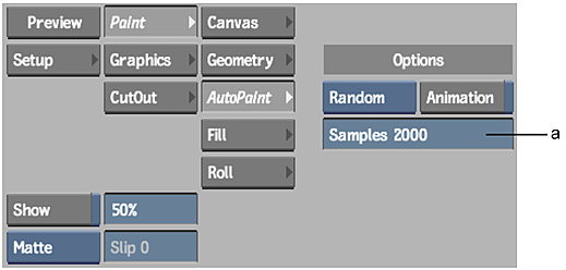

  1. Click AutoPaint and select Random from the AutoPaint Mode box.
    The Samples field appears.
    (a) Samples field
  2. Enter the number of strokes you want to apply in the Samples field.
