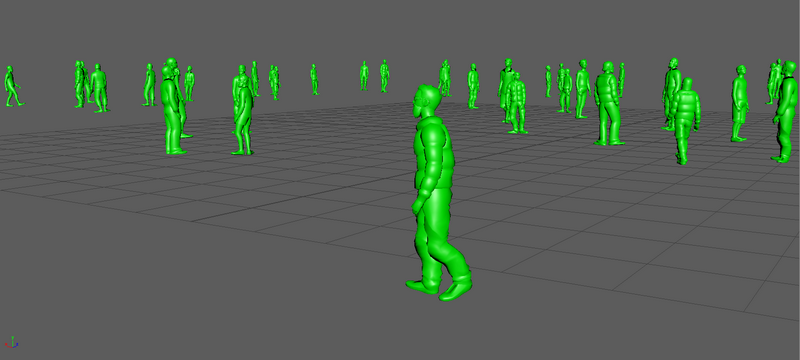

This sample shows how to use the Simulation Cache API and Geometry Generation API to load a Golaem cache, and generate the entities geometry.
Result of a Cache Reader node

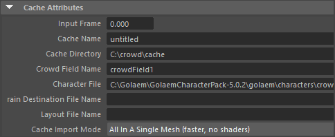

CONFIGURATION
This node defines the following attributes:
Input Frame Number of the frame to load
Cache Name Name of the Simulation Cache to load
Cache Directory Directory where the Simulation Cache files have been exported
Crowd Field Name Name of the CrowdField to load
Character File File path to a Golaem Character File
Terrain Destination File Name Directory for the generated terrain if any
Layout File Name Path to the history file of the cache (gscl) if any
Cache Import Mode
There is two import modes :
  • All in a single Mesh : This will import the whole cache in a single mesh. It is faster to process, but there won't be any shader information on this mode, only raw geometry
  • One mesh per entity & asset : This mode is slower, and will split the scene into each mesh asset as it would be done on an equivalent FBX or alembic import. If the shaders are present, they will be linked. Note that this mode is closer to what our renderer plugins : the instances & shaders can only be handled correctly by doing so.
