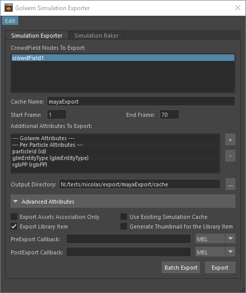

| Crowd Field Nodes | List of all the available Crowd Fields. Only the Crowd Fields selected in this list will be exported. |
| Cache Name | Exported cache file name. |
| Start Frame | First frame to export. If the selected Crowd Fields are started after this frame, the export will only start at the frame at which the Crowd Fields start. |
| End Frame | Last frame to export. |
| Additional Attributes | Additional per particle attributes or Golaem Attribute to
export in the simulation cache. Attributes can be added using the +
button and removed using the - button.
Caution:
Note that the PP or Golaem attributes used as shader attributes must be
exported.
There is no default Golaem Attributes exported. The default exported PP attributes are:
| Output Directory | Directory in which the Simulation Cache files will be exported. It is possible to specify one directory per Crowd Field by manually setting each directory (separated by ";"). |
Advanced Attributes Panel
| Export Assets Association Only | If checked, only the gscs file (containing the Assets Association data) of the Simulation Cache is exported |
| Use Existing Simulation Cache | If checked, avoids running the simulation if a simulation cache already exists, and only exports the renderer files. |
| Export Library Item | If checked, exports a Library File (.gscb) for the currently exported simulations. |
| Generate Thumbnail for the Library Item | If checked, the exported Library File (.gscb) will also contain a valid thumbnail (else it will be a grey image). |
| PreExport Callback | MEL/Python script command called just before the Simulation Export starts. If the callback code returns an error, the export process is cancelled. |
| PostExport Callback | MEL/Python script command called just after the Simulation Export stops or fails |
