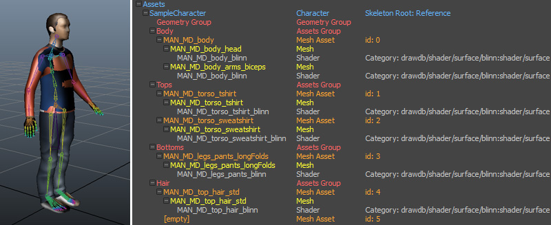

Character File (.gcha)
The Character file lists the meshes of a Character and defines characters appearance when rendering. Those information are stored in a .gchafile (which is actually a xml). Here's how those information are stored in a .gchafile for the following example:
And the corresponding .gcha file:

Character
A Character in the Assets Manager is a description of a pool of assets (meshes and shaders) available when rendering an Entity. It's the main container of the Assets Manager and is defined the following way:
<inspectableObject pointerID="1" typeName="AssetManager">
    <id value="0"/> // Character id (must be unique)
    <name value="SampleCharacter"/> // name of the Character
    <skeletonRootName value="Reference"> // name of the root bone of the Character
<geometryGroup pointerID="2">
         // Geometry Group information (see below)
    </geometryGroup>
<assetGroups>
         // Assets Group information (see below)
    </assetGroups>
    <meshesShaders>
         // Shaders information (see below)
    </meshesShaders>
    <blendShapeGroups>
         // Blend Shape information (see below)
    </blendShapeGroups>
</inspectableObject>
