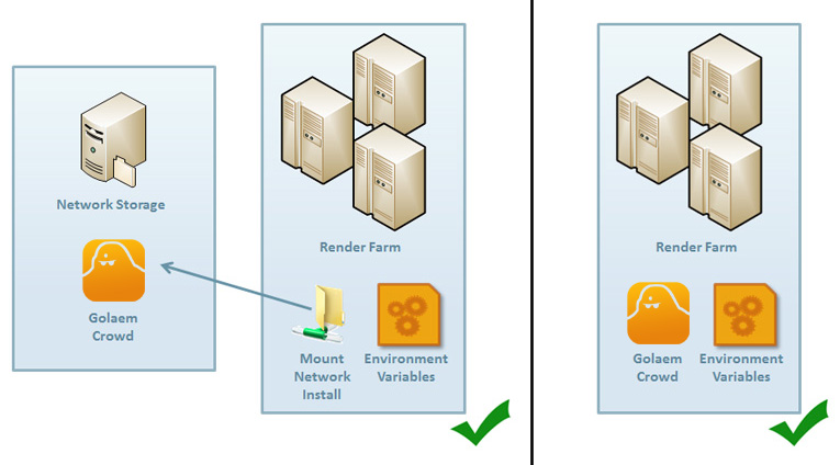

Hence, to be able to render a Golaem Simulation on the Render Farm, all render nodes must be able to load the Golaem Maya plug-in and the renderer specific procedural plug-in. To install those, you can use the same installer than the one used to export the simulation.
The plugins files can either be installed:
  • locally (as they could be installed on an artist workstation, see above).
  • or on a network share
Depending on your installation method, the Golaem Maya Module may need to be referenced through the MAYA_MODULE_PATH environment variable in order to be correctly loaded. If using the provided .mod file, the Golaem Maya Module should automatically set the right environment variables for the renderer specific plugins to be loaded. See Configuring Render Farm Manager for a complete description.
