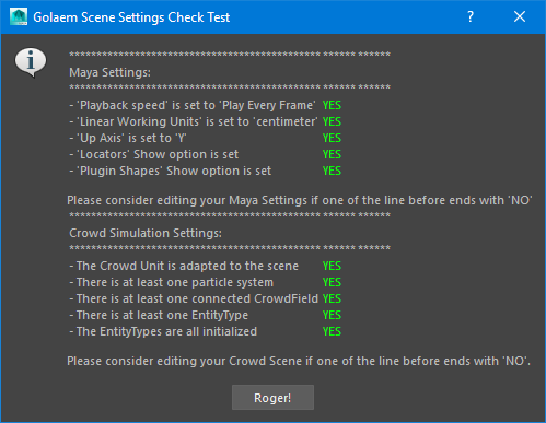

Configuring Maya
To work properly, Golaem Crowd requires some specific Maya settings (time unit, distance unit…). To check your Maya configuration, run the Golaem Crowd Check Scene Tool using menu Golaem > Check Scene Settings.
You may consider editing your Maya settings if one of the lines of the tool ends with "NO".

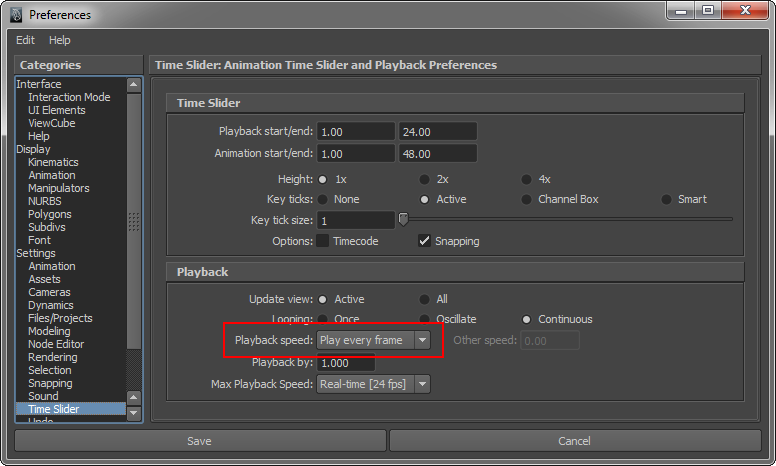

Playback Speed
As the plug-in relies on Maya particles, it is highly mandatory to activate the "Play every frame" option in the Playback speed. Thus, when the simulation is running in Maya, it will make ensure that no frame will be dropped, even if the playblack speed in not interactive.
Open the Maya Preferences window (Window > Settings / Preferences > Preferences) then select the Settings > Time Slider category:
Finally, it can be convenient to set the maximum playback speed of the simulation at "Real-time".This parameter can be modified in the Max Playback Speed option of the same configuration window.

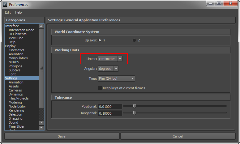

Linear Working Units
Currently Golaem Crowd only supports the "centimeter" Linear Working Unit (default Maya value). More importantly, by default, Golaem Crowd considers that one Maya Unit equals one meter. This convention can be easily changed if needed (see the Simulation Unit part below).
To change the Linear Working Unit, open the Maya Preferences using menu Window > Settings / Preferences > Preferences then browsing the Settings category:
Up Axis
Currently Golaem Crowd only supports the "y" up axis world coordinate system. To change the Linear Working Unit, open the Maya Preferences using menu Window > Settings / Preferences > Preferences then browsing the Settings category:
