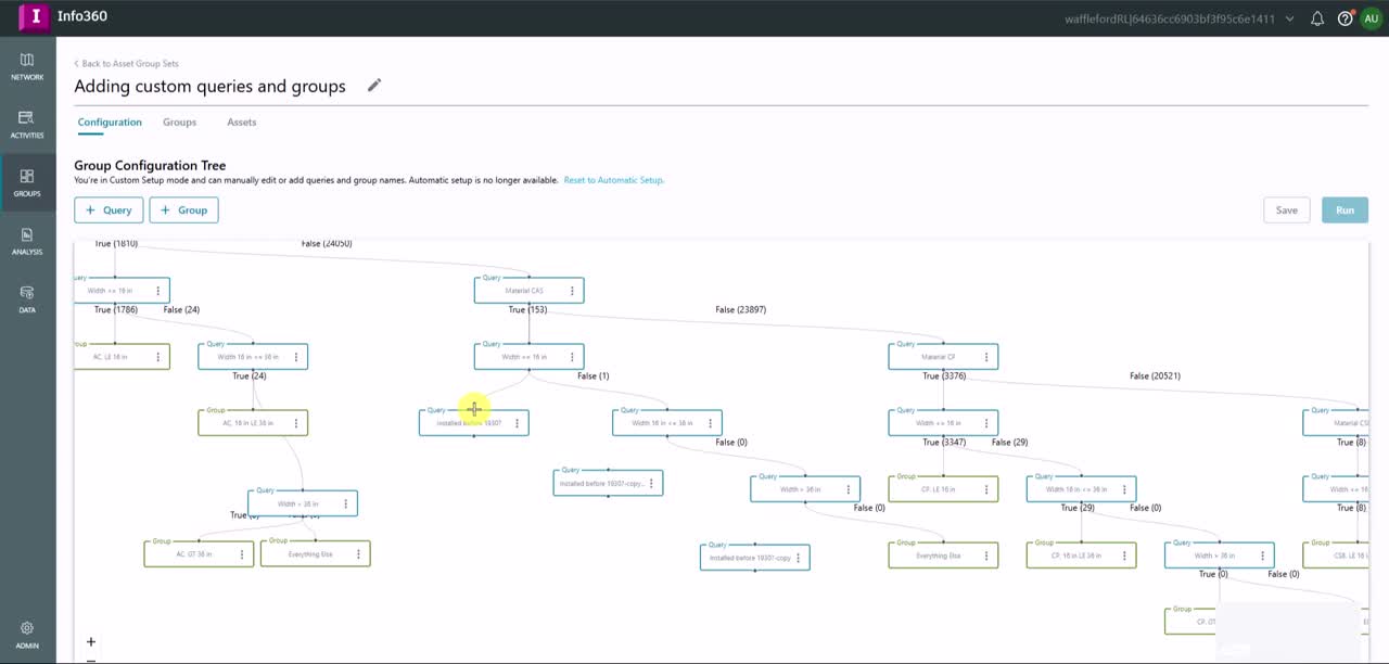

Example: Adding custom queries and groups
In this example, we have used the automatic setup to generate groups based on material and diameter, and will now add custom queries to break the Cast Iron groups up into pre-1930 and post-1930 installation.
