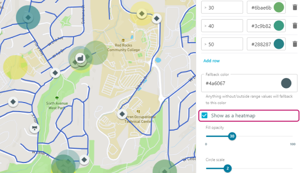

For sensors specifically, you can also choose to display latest sensor values as a heatmap. Mark the Show as a Heatmap option.
