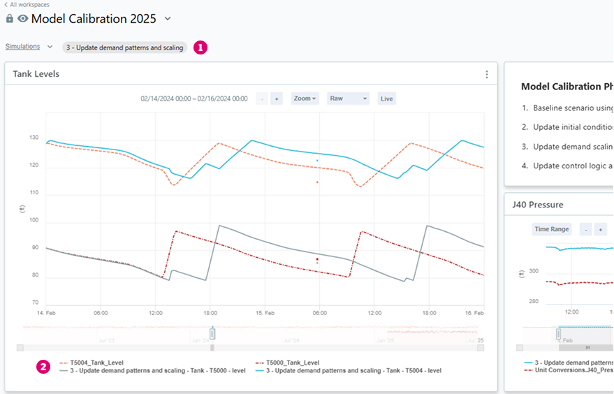

May 2025 | InfoWater Pro users can now share and use model simulation results in Info360 Insight workspaces.
This allows you streamline the process of hydraulic model calibration by comparing simulation results with real-world SCADA or IoT data that Info360 Insight has retrieved.
[1] You can choose a default simulation for the workspace and its charts. You can use the drop-down list of simulations to switch to another simulation. When you do this, the workspace charts will be updated to replace the former simulation results with the newly selected simulation results.
[2] One or more simulation data sources can be added to historic charts for easy comparison of simulation results with observed SCADA results, or with other simulation results.
You can also publish simulations to the Info360 Insight map, so that when you select assets on the map you can view their associated simulation results.
