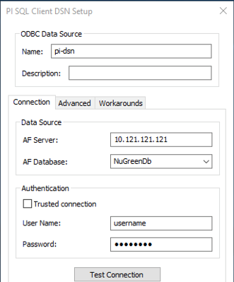

For RQTP-based DAS (modern PI servers)
- Run the Windows ODBC Data Source Administrator (64-bit) tool, go to the System DSN tab and select Add to add a temporary system DSN.
- Double-click on the PI SQL Client driver you installed.
- Enter a name for your DSN.
- On the Connection tab, fill out the following fields:
- AF Server: IP address or hostname of the RQTP-based DAS machine.
- AF Database: Specify the AF database.
- Trusted connection: This is typically unchecked, but this depends on your security setup.
- User Name and Password: These are used for testing the connection but not used by the DSN.

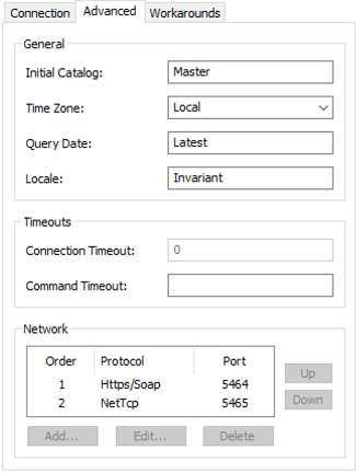

- On the Advanced tab:
- Specify the time zone.
You will also need to specify the time zone when creating a System Connection, and these settings must match.
- Configure the firewall.
PI drivers support two protocols, whose ports and order are configurable. The typical port selection for PI SQL Client drivers is (NetTcp) 5465.
Make sure this port is opened between the PI server(s) and the Info360 Plant Data Connector.

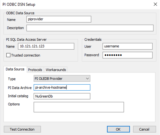

For OLEDB-based DAS (older PI servers)
- Double-click on the PI ODBC driver you installed.
- Under PI SQL Data Access Server, fill out the following:
- Name: IP address or hostname of the OLEDB-based DAS machine.
- Under Credentials, fill out the following:
- User and Password: These are used for testing the connection but not used by the DSN.
- Under Data Source, fill out the following:
- Type: PI OLEDB Provider
- PI Data Archive: Enter the hostname of the PI archive (not an IP address)
- Initial Catalog: Default database
- On the Workarounds tab, we recommend that you check the following boxes:
- Variant as String
- Guid as String

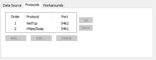

- On the Protocols tab, configure the firewall:
- PI drivers support two protocols, whose ports and order are configurable. The typical port selection for PI ODBC drivers is (NetTcp) 5462.
- Make sure this port is opened between the PI server(s) and the Info360 Plant Data Connector.
