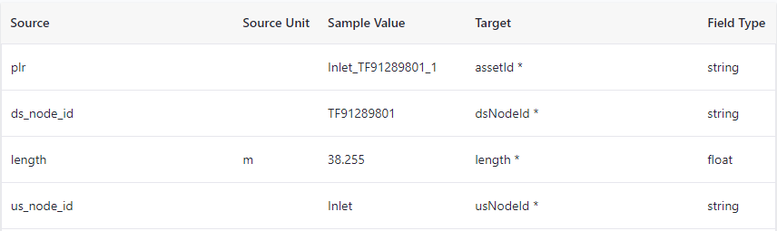

  4. If this is a new layer, map the fields in your source to the fields in Info360 Plant (Target) by clicking on each row and selecting the Source Field. Fields with an asterisk* are mandatory to map.
    You will see a Sample Value for the field you are mapping to help you verify it is the correct field. If you are mapping a numerical field, you must also specify the Source Unit.
    The Target Type column shows the expected field type, such as string (text) or float (numerical).
    Note: For pipes that are divided into multiple segments (between two manholes) in the GIS, you can map the individual segment IDs. If the segment ID field is not mapped, Info360 Plant will automatically generate IDs.
    If the pipe is not divided into segments (that is, there is a single pipe segment between two manholes), you do not need to use the segment ID field and the single pipe asset will be treated as a single segment.
