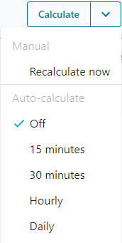

    You can also set up the analytic to auto-calculate at a given interval. Click the drop-down arrow beside Calculate to set this up.
