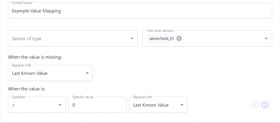

Create a Value Mapping Profile
- Go to Admin
Value Mapping and click Create Value Mapping.
- Give the profile a name.
- Select:
- A Sensor type: This profile will be applied to all sensors of this type, except for sensors that have their own specific value mapping profile configured (individual sensor value mapping profiles take precedence over sensor type profiles).
- And/Or, Individual sensors: This profile will be applied to these specific sensors.
- Select a rule for when the value is missing: replace with last known value or with a custom value.
- Configure one or more additional rules to replace anomalous data. For the example value mapping below, the configuration would be:
You can remove this rule (using the minus button) if you only want to replace missing values.
- Click Save.

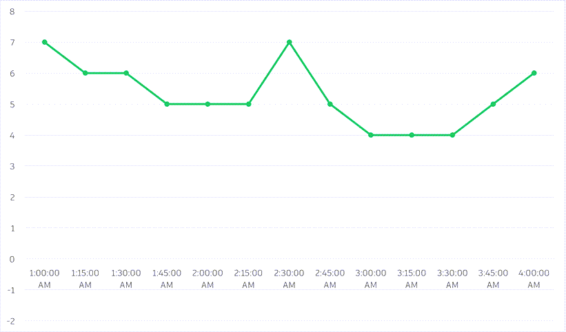

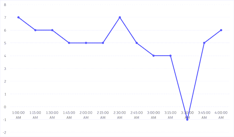

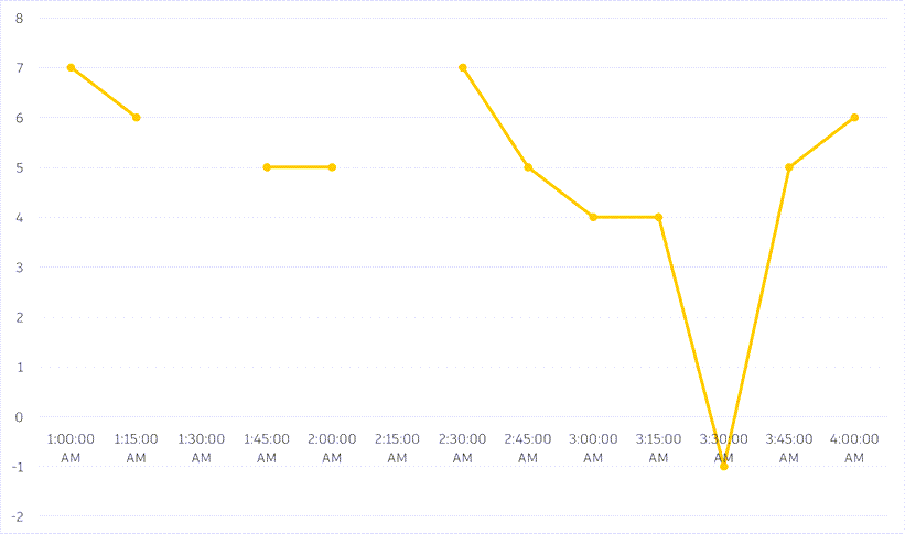

In the example below, we have a sensor whose data is read every 15 minutes (the sensor's interval is set at 900 seconds). In the raw data series, there are several missing data points and one anomalous reading (-1). Using a value mapping profile we can clean the incoming data to address the missing and bad values.
| Raw sensor data | Missing values replaced with last known value | Anomalous values replaced with last known value | |
| 1:00:00 AM | 7 | 7 | 7 |
| 1:15:00 AM | 6 | 6 | 6 |
| 1:30:00 AM | 6 | 6 | |
| 1:45:00 AM | 5 | 5 | 5 |
| 2:00:00 AM | 5 | 5 | 5 |
| 2:15:00 AM | 5 | 5 | |
| 2:30:00 AM | 7 | 7 | 7 |
| 2:45:00 AM | 5 | 5 | 5 |
| 3:00:00 AM | 4 | 4 | 4 |
| 3:15:00 AM | 4 | 4 | 4 |
| 3:30:00 AM | -1 | -1 | 4 |
| 3:45:00 AM | 5 | 5 | 5 |
| 4:00:00 AM | 6 | 6 | 6 |
Raw sensor data
