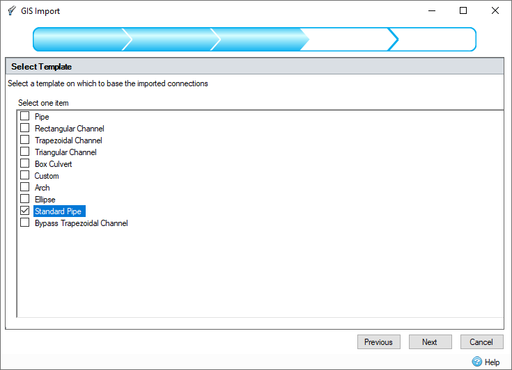

- This step allows you to select which Connection Template will be used if any missing attribute data exists, in this case select Standard Pipe for the Template. Click
Next.
