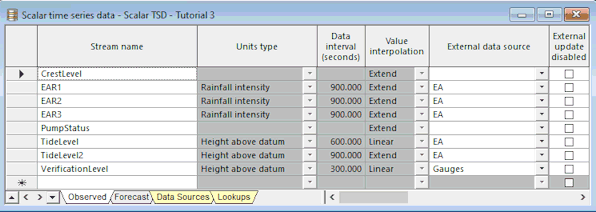

An example of a configured scalar TSD
The Observed and Forecast pages contain information about observed and forecast streams respectively. The Data Sources page contains details of the corresponding external sources while the Lookups page is used to map alphanumeric text, in the imported time varying data, to numerical values which are recognised by InfoAsset Manager.

The following stream properties apply to both observed and forecast streams unless otherwise stated:
Field Description
Stream name
The data stream name.
When using Simple CSV format as the data source type, the data stream name will be used to identify the file containing the live data feed by default.
When using FW Format1 (FloodWorks Data Transfer File Format 1) as the data source type, ensure that each individual data stream in the multiple stream FloodWorks file is assigned to a single stream name in InfoAsset Manager.
Units type*
The type of data measurement.
Data interval*
The expected maximum time interval between successive values. This is used to determine if values are missing at any given time. If each value is valid indefinitely (until superseded by a later value) then set this to 0.
Value interpolation
The value interpolation method defines how values are interpolated when needed at times in-between non-missing values. The options are:
  • Extend - a step function will be used between non-missing values
  • Linear - linear interpolation of values will be carried out between non-missing values
Note that the engine will always use Extend for Rainfall, even if the method has been set to Linear, and will always use Linear for other items e.g. flow, level. The Value interpolation only applies if interpolation is needed when generating the data sent to the engine, for example when you have two flow profiles to go into the event file, but these have different time steps and so must be interpolated to a common time step.

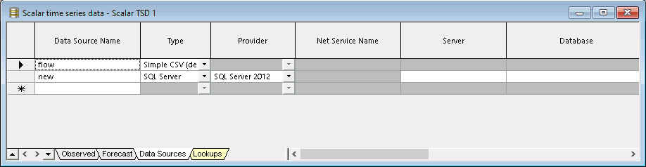

Data Sources page
Data sources are required to connect to external systems to get the time series data for the streams. For example the folder name where RADAR forecast data is stored or the connection string required for a RDBMS such as Oracle.
Note: Data sources are updated sequentially, so if the update of one data source is dependent on the update of another then it should be put before that data source in the list on the Data sources tab. This may occur, for example, if the scripts run third party models where the results of one model feed into another.
TSD
Field Description
Data Source Name
User defined name for the connection.
Type
Dropdown of supported database types:
  • JET
  • Note: It is not possible to use "access" as an external data source when carrying out automatic simulations using the Innovyze Live Server due to incompatibility of JET databases with x64 applications.
  • Oracle
  • SQL Server (SQL 2005 /2008 /2012 supported)
  • PI
  • PI WebAPI
  • ODBC
  • Note: ICMLive requires the classic PI OLEDB provider and not the Enterprise OLEDB provider. Both providers can be installed side by side and do not interfere with each other. However, some of the functionality required by ICMLive is only available through the classic provider.
  • Simple CSV (Deprecated)
  • Batch CSV
  • FW Format1
  • SOPHIE (Pre)
  • SANDRE (XML)
  • iHistorian
  • ClearSCADA
  • EA RestAPI
  • ADS Telemetry

Username to log on to database.
Password
Enabled when Type is set to SQL Server, Oracle, PI, PI WebAPI, iHistorian, ClearSCADA or ADS Telemetry.
For database types other than Oracle and ADS Telemetry, this field is only available when Logon Type is set to Username / Password.
The password to log on to database.
For ADS Telemetry, this is the user key.
The password or user key will be displayed as asterisks in the grid view.
Command timeout
Timeout, in seconds, for obtaining values from the data feeds.
Schema
Enabled when Type is set to SQL Server, Oracle or ODBC.
The name of the user on the SQL Server, Oracle or ODBC database server that owns the database schema.
Filename / Folder
Enabled when Type is set to JET, Simple CSV, Batch CSV, FW Format1, SOPHIE (Pre) or SANDRE (XML).
Path of the telemetry database when using a JET database.
Path of the folder containing data stream .txt files when using Simple CSV format.
Path of the folder containing the comma separated variable formatted files when using Batch CSV.
Path of the folder containing the datastream .dat files to be loaded when using FW Format1.
Path of the folder containing data stream .pre files when using SOPHIE (Pre) format.
Path of the folder containing data stream .xml and xsl files when using SANDRE (XML) format.
Connection String
Enabled when Type is set to ODBC, ClearSCADA or PI WebAPI.
String containing parameters used to connect to the data source.
For PI WebAPI, the only string that can be specified is no_cert (case insensitive). If this is used then the certificates on the server will not be validated. However, this is not recommended and should only be used if a server has been setup correctly or the certificates have expired and the user is prepared to accept the risk.
Time Zone
Dropdown with all the available time zones.
Allows users to select the time zone of the data.
Last Time Series Data Update (UTC)
Read-only.
UTC time that the data source was last updated.
This field is automatically revised by InfoAsset Manager whenever an automatic or a manual update of the data source is carried out.
See Updating Time Series Data for further details.
Automatic Update Disabled
Disabled in InfoAsset Manager .
Automatic Update Start At (min)
Automatic Update Interval (min)
Automatic Update Trigger File
Script

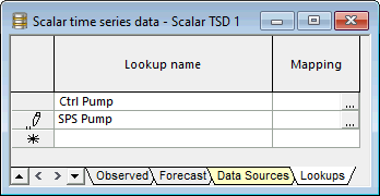

Lookups page
Some imported time varying data is received in alphanumeric text format, and in order for this to be recognised by InfoAsset Manager, it must be converted into numerical values. This conversion is carried out according to the mapping defined in a lookup table, which can subsequently be assigned to a data stream in the Observed and Forecast pages.
TSDB
Field Description
Lookup Name
User defined name for the lookup conversion table.
Mapping
Click to display the Live Data Lookup grid editor, which is used to map alphanumeric text to numerical values.
