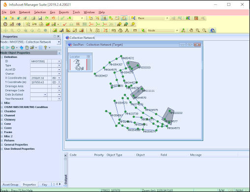

An example of the InfoAsset Manager workspace when using anInnovyze licence:

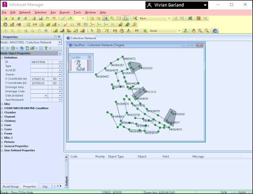

An example of the InfoAsset Manager workspace when using an Autodesk licence:
Pink - Menu bar, Yellow - Toolbars, Blue - Main Window, Green - Status bar
