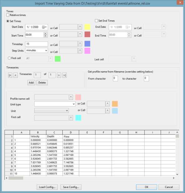

This dialog is a generic importer for time varying data. You can identify a column containing time information, or set a start time and timestep for the data. For each column of time varying data a unit type can be set.
The dialog is displayed if you right click on a Time Varying Data or Time Varying Data Event and choose Importfrom generic CSV file from the popup menu.

Set Times
Used when importing files with no date-time column to specify the time range of data to be imported and the time interval between data values. It is also used to specify timestep and timesep units when using Relative times.
When importing from standard logger format, the start date-time and timestep fields should be automatically set from the file header.
The fields can be manually edited by entering data directly. Alternatively, click on a cell in the grid at the bottom of the dialog and then on the * button next to the Cell field to add the current grid cell to the Cell field.

Use the Timeseries section to view and edit parameters for each data series in the file, which are displayed in the grid at the bottom of the dialog.
Use the arrow buttons to scroll between each data series.
Data series can be added or deleted for import purposes (the underlying file will not be edited).

Grid Window The file being imported is displayed in the grid window.
Load Config
Loads previously saved settings from a .cfg file.
Save Config
Saves the current dialog settings to a configuration (.cfg) file.
