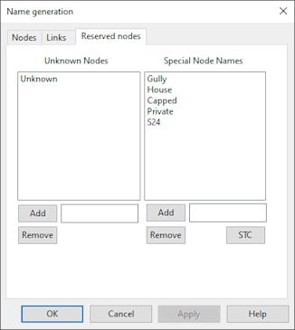

Reserved nodes
The Reserved nodes tab is used to set up reserved names for use as the US Node ID and/or DS Node ID of unconnected pipes.
To add an Unknown Nodes name or Special Node Names, enter a name in the box underneath the list of existing names and click Add.
To remove a reserved name, click on the name to be removed so that is highlighted and click Remove.
Click the STC button to automatically add a list of STC25 special node names.
