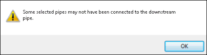

Pipes may not be connected to downstream pipe
If the tool cannot trace through all of the selected pipes / links (and therefore not test the direction of all selected pipes) a warning message will be displayed.
This may occur if selected links to be tested are:
- downstream of the chosen pipe / link to be traced from (Collection Networks)
- upstream of the chosen pipe / link to be traced from (Distribution and Asset Networks)
- not directly connected to each other e.g. in a subnetwork or connected via unselected links

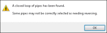

Closed loop of pipes / links found
If the network contains a closed loop, a warning message will be displayed.
Links that are in the correct direction with respect to the chosen pipe / link, may be selected as being in the wrong direction as a result of the trace through a loop. You may wish to refine the selection of links to be tested to avoid tracing through a loop.
If a closed loop is found, the direction of links in the closed loop should be assessed manually before using the Link Reversing tool to correct direction.
