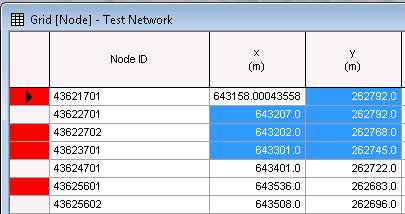

Note: You can select individual cells or groups of cells on the Grid Window without it affecting the network object selection. You just cannot select entire rows.
The picture above shows a number of selected network objects (red markers) with a separate block of selected cells.
